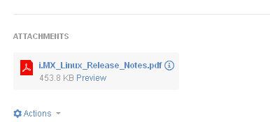

liangmu
Dear,
"Nxp bsps software codec performance is described in  Table 30",Which document?
2,198 Views
igorpadykov
document in attachment previous answer (in red).
