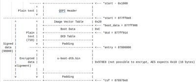

We've observed that the imx header on i.MX 6SX's QSPI U-Boot is 0x718. All the HAB documents consider imx header to be a constant 0xC00.
This variation causes issues with HAB encryption.
1. How can we have the proper padded imx header on QSPI image?
2. Is this header size an issue or is it intended for any reason?
3. How can we encrypt QSPI U-Boot for i.MX 6SX SABRE-SD (EVK)?
