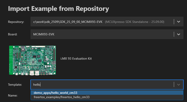

I'm trying to import the hello_world_ns example project from the mcuxsdk repository in MCUXpresso for VSCode. In the Import Example from Repository dialog box I select the SDK (I've tried both 25.6.0 and the latest 25.9.0) the MCIMX93-EVK board, trustzone_examples/hello_world_ns, Freestanding Application, the project name and location, and the toolchain Arm GNU 14.2.1. This is running on a Windows 11 PC.
After processing for several seconds, this give the popup message "Error: Failed to create freestanding example". When I look in the output tab under the MCUXpresso for VS Code filter, I get this output:

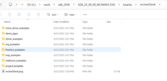

I tired to reproduce this issue on my side, but I didn't see trustzone_examples .   only saw hello_world_cm33
