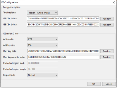

With MCUXpresso user guide reference, I have tried the following steps for booting image in IEE encrypted image authenticated (RT11xx) mode.
To build the image, followed the below steps :
  1. In the Toolbar set Boot type to Encrypted (IEE) authenticated.
  2. For Source executable image, used the sample blinky/ Hello world program available in the MCUXpresso SDK.
  3. Keys generated in the PKI management.
  4. Use the following keys selected the  key, SRK1: IMG1_1+CSF1_1.
  5. Clicked the IEE encryption menu to open the IEE Configuration window. In the window set, configured the number of IEE regions (contexts), KEK, AES encryption mode, and user keys for regions, regions ranges, random key generation.
  6. Clicked Build image.
  7. Check that the bootable image was built successfully.

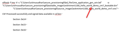

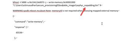

jeremyzhou
Thanks for your reply.
After double-checking the log, I find you create the boot image: evkmimxrt1160_hello_world_demo_cm7_bootable.bin firstly, however, after that, you program the zephyr_nopadding.bin to the MCU, it seems to be a bit weird, please clarify it.

vishnusudhankj
@jeremyzhou
1. Source file -> Sample hello world available in the MCUXpresso IDE , set the XIP_BOOT_HEADER_ENABLE=0 and build the image & provided in the SPT tool as below,
For build & write log , please find the attached file. iEE_log_spt.docx

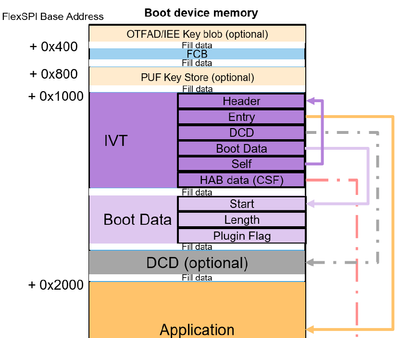

jeremyzhou
After going through the iEE_log_spt.docx, I find the base_addr is 0x30001000 that the IEE key blob is placed at.
However, it doesn't conform to the Boot image layout, and I'll confirm it with the SPT team later.
TIC

vishnusudhankj
HI @jeremyzhou
Sorry for confusion, attached latest log (IEE_SAMPLE_HELLO_WORLD_LOG.docx)
--> For this , Seems the keyblob written at 0x3000000 location , so as showed in the image layout , its written at proper memory location , but upon reset execution of application image is getting failed.
blhost succeeded

jeremyzhou
Firstly, I agree with you that the above commands are in charge of programming the key blob.
Next, in the AN13250, it mentions that
the IEE key blob containing keys and context structures (Table 4) is encrypted by a KEK according to the RFC3394 key-wrapping algorithm, because the key blob resides in the external memory along with the image and it must be protected. The IEE key blob will be protected by AES-512-XTS.
So in my opinion, the IEE key blob is necessary no matter choose AES-CTR or AES-XTS for encrypted XIP.
Meanwhile, in the 4.6.4 Encrypted XiP with IEE section in the ANAN13250, it set BASE_ADDR=0x30000000 which is the beginning address of the external QSPI flash and it is used in the below command.
set IEE_LOCK=0
image_enc.exe ifile=output_file_signed.bin ofile output_file.bin base_addr=%BASE_ADDR% ikbek1=%KEK1%
ikbek2=%KEK2% iee_arg=[%AES_XTS_KEY1%,%AES_XTS_KEY2%,%START_ADDR%,%END_ADDR%,%SEC_MODE%,%KEY_SIZE%,
%IEE_LOCK %]
However, in the SPT tool, the base_addr will have a 0x1000 offset.

vishnusudhankj
@jeremyzhou
Thanks for answer,
1. For IEE -> I used AES-CTR 256 (mode & key size) for Encrypted (IEE) authenticated.

jeremyzhou
Hi @vishnusudhankj ,
Just a reminder.
After double checking, the AE team replicated the issue and they found that SPT lost IVT data of the application image, in another word, if SPT programmed the application image without IVT data, it should cause the boot to fail. Now we could confirm that it is caused by the SPT tool. We will submit a ticket to the tool team in order to fix the bug.
