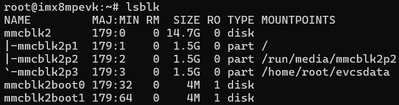

We have a custom board based on the i.MX8MP-EVK, with a 16GB eMMC (as shown below).
Our image includes the dbg-pkgs package, so the resulting .wic.zst file size reaches about 8GB. When we try to flash it to the eMMC using uuu, the flashing process seems incomplete — it is expected to take around 10 minutes, but it finishes in just 2 minutes, and the board fails to boot afterward.
The uuu version we’re using is 1.4.149, and the command executed is:
./uuu -b emmc_all imx-boot-imx8mpevk-sd.bin-flash_evk imx-image-multimedia-imx8mpevk.rootfs.wic.zst

Is there any way to completely flash a large image to eMMC?
Or are there specific uuusettings or partition layout adjustments we should apply for large images?

joanxie
do you mind giving me the download log? add -v in the uuu command, and could you confirm if your image is fine or not? for the partition questions, you can refer to the discussion here
IMX8MN-EVK EMMC Partition from UUU tool - NXP Community
