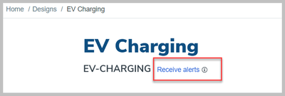

Please stay tuned, for any news, by enabling alerts on our following pages:
https://www.nxp.com/design/designs/ev-charging:EV-CHARGING
https://www.nxp.com/applications/automotive/software-defined-vehicle-infrastructure/ev-charging-stat...
https://www.nxp.com/design/designs/easyevse-ev-charging-station-development-platform:CONNECTED-EV-CH...
