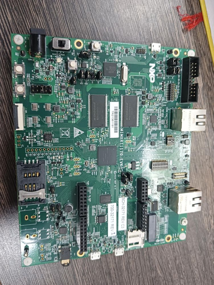

As of now , i have one sample bin file,How can i write with in QSPI bootloder ,and its When ever Started code boot from Qspi ..

Hi @Arivuvp ,
  I think you mention MIMXRT1050-EVKB board, please help to check the board at first.
Or you can give me your board photo, then I can help you to check the details.
  At first, you need to make sure your board hardware is using the QSPI, then you can do the QSPI flash boot, RT1050-EVKB is using the hyperflash in default, so, if you want to use the QSPI, you need to modify the hardware resistor to select the QSPI flash.
 About the detail QSPI flash usage, please refer to this application note:
https://www.nxp.com/docs/en/application-note/AN12108.pdf
Wish it helps you!
Kerry

Arivuvp
sorry..I am using  IMXRT1170 EVK board  not 1050 ..

kerryzhou
Hi @Arivuvp ,
  If you are using the MIMXRT1170-EVK board, it's more easy, as it is just the QSPI flash boot directly.
  About the code, please refer to the SDK code, all the SDK demo are booting from the QSPI flash.
  You can download the SDK code from this link:
https://mcuxpresso.nxp.com/en/builder?hw=MIMXRT1170-EVK
  You can run this simple demo directly:
SDK_2_12_0_MIMXRT1170-EVK\boards\evkmimxrt1170\demo_apps\led_blinky\cm7
If you meet any issues, you can refer to the doc in the SDK:
\SDK_2_12_0_MIMXRT1170-EVK\docs\Getting Started with MCUXpresso SDK for MIMXRT1170-EVK.pdf
Wish it helps you!
kerry

Arivuvp
Please find attached board photo..And i have followed (https://community.nxp.com/t5/i-MX-RT/i-MX-RT1170-with-MCU-Boot-Utility/td-p/1303418) this procedure.IMXRT1170_EVK.jpg
