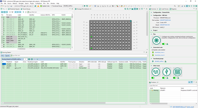

I hav a MIMXRT1064 EVK board
I have MCUXpresso 11.3.1
I have 1064 SDK 2.9.2
Pins configuration tool won't open for imported SDK example projects
It just says
'Propcessor 'MIMXRT1064xxxA' is not supported or data for processor not available (check internet connection)Open configuration failed due to unknown reason.
Please advice how to make this work.

billchadwick
Thanks Victor,
I am indeed behind a corporate firewall. I have configured the Eclipse proxy settings for it and e.g. check for updates works OK. If the tools are using Java, am I able to configure the JRE they use? If not, can you please tell me which keystore on my PC Xpresso will use as I may need to add some certificates to it.

billchadwick
Thanks for that link with instructions for locating the log file.
I think that the problem is to do with the Thales UK coprorate proxy server using untrusted https certificates.
The normal solution for this with other tools (e.g. Android Studio) is to install the certificates to the tools. An alternative is to find the JRE that the tool is using and install the certificates to the keystore for that JRE using the java keytool. My log is as below.

billchadwick
OK so now I have installed our proxy's certificate chain to the cacerts store at C:\nxp\MCUXpressoIDE_11.3.1_5262\ide\jre\lib\security using keytool
The Pins tool is working!
Thanks again for pointing me at the log file.

Is there an error log somewhere that I could check to see why this fault is happening on my setup?
3,082 Views
victorjimenez
I made a couple of tests on my end, and I wasn't able to replicate the behavior that you mentioned. I confirmed that I'm using the same version of the SDK and the IDE as you.
This error might be due to your internet connection. If you are connected to your workspace network, there might be the possibility where the firewall it's blocking this. Could you please try with a different network to see if this solves the behavior you are facing?
