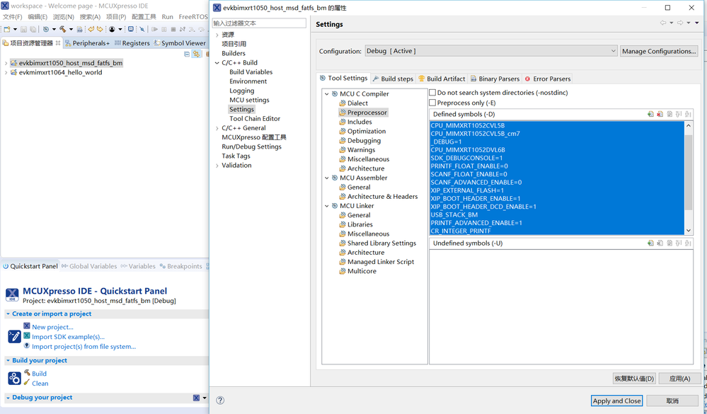

Hello, in continuity to my previous question: https://community.nxp.com/thread/490615, I am posting my code to see if anyone can help me.
Note that in order to test I commented the while (1) {} that calls the screen initialization and I made a new loop to run the USB.
To test if the monitor is working, just comment the USB loop and uncomment the LCD loop.
I did so to test.

Have you also copy the "Defined symbols" to the project?
You can find the "Defined symbols" in the project's properties.

Hi jimmychan,
I tried this too, there were even some macros disabled. So I copied the USB symbols to the project and enabled the macros, but even then, only the screen works the USB does not.
Grateful for the attention.
