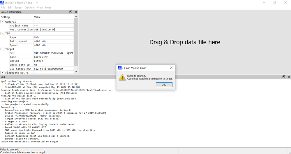

I am using IMXRT1050EVKB with eclipse IDE for my project. I try to flash the board and getting ERROR MSG "Failed to get CPU Status" and a Red led is continuously blinging on the development board.
using the jFlash and tryed to connect to the board ERROR MSG "failed to connect Could not establish connection to target"
Complete log :
- Connecting via USB to probe/ programmer device 0
- Probe/ Programmer firmware: J-Link OpenSDA 2 compiled May 27 2019 11:01:03
- Device "MIMXRT1052XXXXB - QSPI" selected.
- Target interface speed: 1429 kHz (Fixed)
- VTarget = 3.300V
- Failed to attach to CPU. Trying connect under reset.
- Found SW-DP with ID 0x0BD11477
- SWD speed too high. Reduced from 1429 kHz to 963 kHz for stability
- Failed to power up DAP
- Connect fallback: Reset via Reset pin & Connect.
- ERROR: Failed to connect.
Could not establish a connection to target.complete
Boot Configuration : sw7 is 0110
changing boot Config to 0101, J1 connection to 3-4 ,micro usb connected to j9, I am able to connect to the "NXP-MCUBootUtility"  after a mass erasing the board. and switching back to old configuration then I am able to flash it.
But after 1 or 2 flash I face the same Issue again. How to resolve this issue

Hi @SanjuDevassy ,
   From you description, you are using the JLINK as debugger, which JLINK you are using now? the EVKB on board debugger firmware or the external debugger?
  From your log: - SWD speed too high. Reduced from 1429 kHz to 963 kHz for stability
  Seems the connection is also not very good, not stable. So, please also need to check the hardware connection, as if the downloading is not stable, and downloaded code is valid to boot, it will also influence the debugger to connect, then it will need to do the mass erase to let it back.
Kerry
