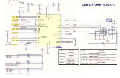

Hi all, hope this email finds you well, I'm trying to develop a custom board using IMXRT1021DAG, this board has an ethernet interface based on the same ethernet interface of the EVK.
In fact I'm using the same PHY KSZ8081RNB, and the circuit is almost the same of the EVK too (I didn't put the pull ups resistors on the analog side because those are implemented inside the PHY):

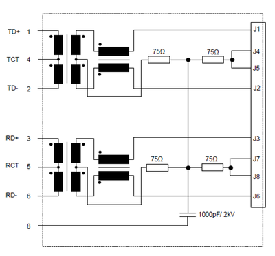

The only difference is the RJ45 connector, I'm using Thru hole (WURSHT 7499010211A) against the SMD of the EVK, just for robustness, but the internal transformers and parameters are the same:

I've checked the PCB, the components, the routing of RJ45 is similar to EVK, keeping differential pairs togueter and impedance low 100Ohm.
I really don't understand what is happening, any idea would be very appreciated.

nicolasmuratore
I found it!!!
One of the resistors that controls the output power, with a value that should be 6.49K, is wrongly 64K, so the output didn't have enough power to transmit signals, my components supplier made a mistake.
Now is working, besides that I solved some welding problems too.
Many thanks for your guidence on this issue.

Hui_Ma
From the problem description, the only difference at Ethernet circuit design is the PHY.
And customer board could receive data frame from EVK board sent.
Besides of PHY circuit and soldering review, please check the Ethernet cable status.
