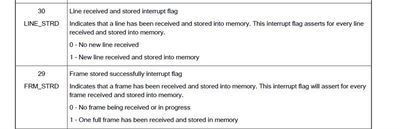

3,157 Views
Bio_TICFSL
I checked with design about whether i.MX93 MIPI CSI has such FS/FE interrupt, unfortunately, there is no MIPI CSI interrupt about it. He mentioned there is an interrupt in ISI named as below that could do similar function:
It means whether the frame is stored successfully into memory. Although it is different with when MIPI CSI receive frame start/end packet, they could take a reference.
3,281 Views
Bio_TICFSL
"With Line Interrupt Ratio" to 0x1. this setting, the LINE_END interrupt will be raised each time the Line End packet is detected on a specific MIPI CSI2 lane.

3,167 Views
Bio_TICFSL
From i.MX93 MIPI CSI RM, I haven't seen such interrupt that could indicates frame start or frame end MIPI CSI receives. Let me check with R&D if there is a way to get it. Will reply later.
regards
3,158 Views
Bio_TICFSL

takayuki_ishii
Contributor V
Hello @Bio_TICFSL
Thank you for your reply.
I understand that MIPI-CSI module has no interrupt status signal.
But it is replaced by the ISI status signal, which does not exactly match.
Ishii.
