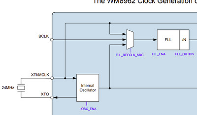

.fllClockSource = kWM8962_FLLClkSourceMCLK

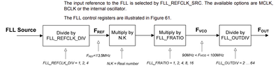

You are configuring the FLL to take MCLK as reference clock source.
According to the WM8962's Datasheet, you can select between MCLK, BCLK and Internal OSC:
Then, if you're not using MCLK, SAI must be master to generate BCLK and FSYNC for the codec:
saiConfig.masterSlave = kSAI_Master;
And codec as slave as you did:
WM8962_IFACE0
Please try with those configurations.

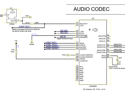

If you are having more issues after those configurations, please share your schematic related to the CODEC.

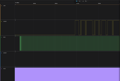

So with master i can see a short period of bCLK and ADCDAT. But nothing from DACDAT with my playing sound data. Also the interrupts seems not being trigged.
