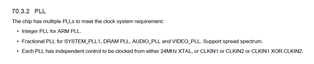

I am designing a system with IMX93 where I need to clock the enet_clk_root and enet_timer2_clk_root from external clock other than XTAL_24. According to section 70.5 of the reference manual (page 5240), I can use CLKIN1 or CLKIN2 to clock any of the system PLLs, the problem is that I cannot find how to configure the PLLs to use CLKIN1 instead od XTAL_24. Am I missing something?

CLKIN1/2 are only used for our internal testing, so its reference clock cannot be switched.

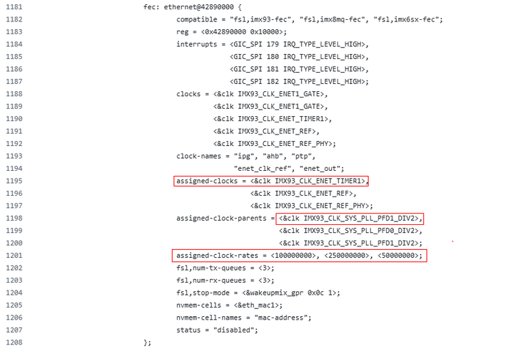

The locations in DTS file you have suggested, define which PLL is the parent for the selected Ethernet clock. (according to the datasheet, the parent for the timer1 clock can be PFD1_DIV2, PFD1_DIV2, VIDEO_PLL). I am looking for a way to set the reference clock of VIDEO_PLL (or other PLL) to be CLKIN1 instead of XTAL_24.

CLKIN1 and CLKIN2 are designed for cases where a very precise clock is required. In this way, IMX can use a clock with the same frequency and phase as the external device.
That should be altsir's case.

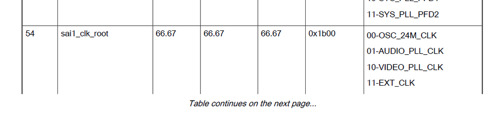

clk_ext1 is the clock in.
It can not only provide a clock source for the PLL. And it can be used directly in some modules.  But need to change some  code in dts.
Here is the example, SAI can use an external clock, so that it can be fully synchronized with external clocks such as codec, with exactly the same frequency and phase.

This could work if there was a way to use EXT_CLK in Ethernet module, but it seems that EXT_CLK could be only used in SAI modules.

CLKIN1/CLKIN2 is for internal test purpose.  If you need to use it, you can try to choose the source,  set the corresponding PLL frequency , please refer to the dts file.
linux-imx/arch/arm64/boot/dts/freescale/imx93.dtsi at lf-6.6.y · nxp-imx/linux-imx
