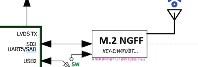

If I read the IMX93-EVK Expansion board manual and the IMX93 reference sheet, then SAI1 should be accessible via the expansion ports on GPIO pins 7, 23, 32, 33. Is that true?
7,778 Views
joanxie
in your source code, do you have driver for simple-audio-card? if you need to use sai1, you need remove other device which uses this

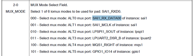

joanxie
refer to the dts file
https://github.com/nxp-imx/linux-imx/blob/lf-6.1.y/arch/arm64/boot/dts/freescale/imx93-11x11-evk.dts
youc an find sa1 mux mode as below
pinctrl_sai1: sai1grp {
fsl,pins = <
MX93_PAD_SAI1_TXC__SAI1_TX_BCLK 0x31e
MX93_PAD_SAI1_TXFS__SAI1_TX_SYNC 0x31e
MX93_PAD_SAI1_TXD0__SAI1_TX_DATA00 0x31e
MX93_PAD_SAI1_RXD0__SAI1_RX_DATA00 0x31e
for example SA1_RXD0, you can refer to the SW_MUX_CTL_PAD_SAI1_RXD0 SW MUX Control Register (SW_MUX_CTL_PAD_SAI1_RXD0)
refer  to the reference manual
SAI1_RDX0 should mux SAI1_RX_DATA00, not GPIO1_IO14

I just refer to the dts file, imx93 board is based on this, you also can refer to the board schematic, SAI1 is used to BT

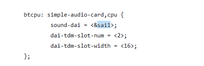

rockerr
I see, yes I made my pcm5102a DT fragment based on that BT config. Is specifying the tdm slot paramters necessary?

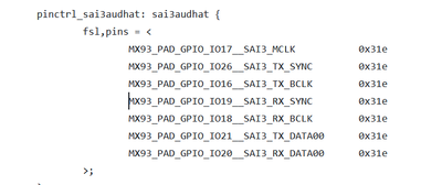

joanxie
I already mentioned before, you can refer to the dts file we offered
"https://github.com/nxp-imx/linux-imx/blob/lf-6.1.y/arch/arm64/boot/dts/freescale/imx93-11x11-evk-aud...
this uses SAI3 and you can access by these GPIO pins
if you use sai1, which is used by BT in dts, you need to disable it firstly before you use it, since imx93 is still under preporduction, I couldn't share more, I already tell you all of information you can find, the dts file, the reference manual and the schematic, pls design and set according imx93 evk board, if you have further request, pls contact beta group team

I've read all the documents suggested by you and this is the outcome:
* route SAI3 signals to the J1001 connector
* probe simple-audio-card soundcard
Probe errors still happen, changes are made to the imx93-11x11-evk.dts device tree - disabling all the other sound cards and setting the SAI3 clock to a higher value. SAI3 routing is set with reg_audio_switch1 node, similarly to how it's done in the imx93-11x11-evk-aud-hat.dts.
