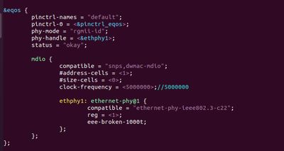

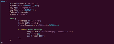

IMX93 has only 100mhz ethernet ,using rtl8211f
951 次查看
5454ty
HI,
   I am using rtl8211f,but my ethernet has only 100mhz
   my dts is as follows:
I would like 1000M ethernet,but only 100M
1 回复
928 次查看
Bio_TICFSL
The MX93 support 1000Mhz Ethernet you can check the device tree on the imx93_EVK.dtb.
