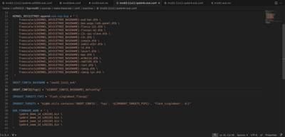

Chavira
Hi @il_ciancio!
I found the problem!
For some reason the fspi configuration is not included.
You have to add the next lines in the imx93-11x11-lpddr4x-evk.conf file.
UBOOT_CONFIG[fspi] = "${UBOOT_CONFIG_BASENAME}_defconfig"
IMXBOOT_TARGETS_FSPI = "flash_singleboot_flexspi"
IMXBOOT_TARGETS = "${@bb.utils.contains('UBOOT_CONFIG', 'fspi', '${IMXBOOT_TARGETS_FSPI}', 'flash_singleboot', d)}"
after that you can maintain the line UBOOT_CONFIG = "sd fspi"  in local.conf file to deploy both images.
Best Regards!

1,257 Views
il_ciancio
Hi @Chavira ,
congratulation, great job!
Now the bitabake is finished and i have u-boot*fspi files in my deploy directory.
Just for clarification, which are the kernel/rootfs image "compatible" with fspi? It is always the *.wic file?
thanks a lot and again great work!
