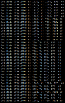

AlanWen
I print out the valid mode from LT9611UXC driver as below
static struct lt9611uxc_mode *lt9611uxc_find_mode(const struct drm_display_mode *mode)
	int i;
	for (i = 0; i < ARRAY_SIZE(lt9611uxc_modes); i++) {
		if (lt9611uxc_modes[i].hdisplay == mode->hdisplay &&
		    lt9611uxc_modes[i].vdisplay == mode->vdisplay &&
		    lt9611uxc_modes[i].vrefresh == drm_mode_vrefresh(mode)) {
			printk("Got Mode LT9611UXC H: %d, V: %d, FPS: %d\n", mode->hdisplay, mode->vdisplay, lt9611uxc_modes[i].vrefresh);
			return &lt9611uxc_modes[i];
	return NULL;
And it shows lots of modes in dmesg, but there are only few modes can be use in the modetest.

Zhiming_Liu
Hi @AlanWen
The mode supported by LT9611UXC is limited by it's firmware not i.MX93. You can refer below commit message. You may need contact Lontium to check logs from firmware.
https://patchwork.kernel.org/project/dri-devel/patch/20200828154906.1662611-3-dmitry.baryshkov@linar...
The lt9611uxc firmware supports only a fixed set of modes. Thus
lt9611uxc driver has to check if the mode is supported by the fw.
Unsupported modes would result in HDMI display not receiving valid signal.
