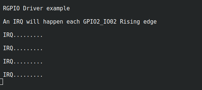

I made a little example using the GPIO2_IO02 as output connected to GPIO2_IO03 configured as an Input with Rising edge IRQ.
In this program, an IRQ will be detected on each rising edge of GPIO2_IO02, Please check the attached.

This is the output of the example:
I hope this example can helps to you.
