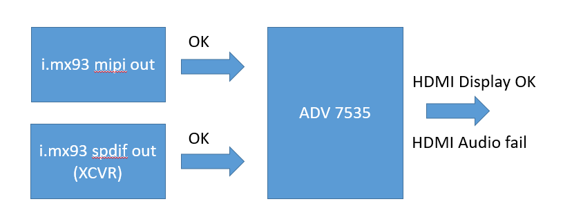

As title, we connect SPDIF output "MX93_PAD_GPIO_IO23__SPDIF_OUT" to ADV7535 audio on our board. So, for this purpose, how should we configure the device tree?

Hi Sir,
My customer would to know how to achieve this function as figure (hdmi audio).
We refer Beacon development board setting and use "i2s" audio card format can work normally. (imx8mm-beacon-kit.dts)

error log message as below.
[ 3.134115] asoc-simple-card sound-hdmi: control 3:0:0:IEC958 Playback Default:0 is already present
[ 3.143195] hdmi-audio-codec hdmi-audio-codec.1.auto: ASoC: error at snd_soc_pcm_dai_new on spdif-hifi: -16

Thank your reply, I tried 'unblank the HDMI' but it look like no use.
Yes, there is no audio output.
I tested by using `gplay` to play a AV file.
The SPDIF_OUT has a signal, but there is no sound heard from the HDMI panel.
And my sound card information as below :
root@imx93afee320a1:~# aplay -l
**** List of PLAYBACK Hardware Devices ****
card 0: imxaudioxcvr [imx-audio-xcvr], device 0: XCVR PCM snd-soc-dummy-dai-0 [XCVR PCM snd-soc-dummy-dai-0]
Subdevices: 1/1
Subdevice #0: subdevice #0
card 1: sgtl5000 [sgtl5000], device 0: HiFi sgtl5000-0 [HiFi sgtl5000-0]
Subdevices: 1/1
The document of `xcvr` say it support HDMI Audio, is there anything that we need to pay attention to?
