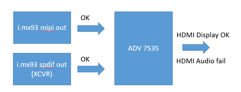

As title, we connect SPDIF output "MX93_PAD_GPIO_IO23__SPDIF_OUT" to ADV7535 audio on our board. So, for this purpose, how should we configure the device tree?

Our board is MIPI to HDMI, and the SPDIF_OUT is connected to the bridge IC.
In theory, it should work. Please refer to the attached document for the device tree modifications.
And please help us confirm where the issue might be? Thank you!

Hi Sir,
My customer would to know how to achieve this function as figure (hdmi audio).
We refer Beacon development board setting and use "i2s" audio card format can work normally. (imx8mm-beacon-kit.dts)

error log message as below.
[ 3.134115] asoc-simple-card sound-hdmi: control 3:0:0:IEC958 Playback Default:0 is already present
[ 3.143195] hdmi-audio-codec hdmi-audio-codec.1.auto: ASoC: error at snd_soc_pcm_dai_new on spdif-hifi: -16

Thank your reply, I tried 'unblank the HDMI' but it look like no use.
Yes, there is no audio output.
I tested by using `gplay` to play a AV file.
The SPDIF_OUT has a signal, but there is no sound heard from the HDMI panel.
And my sound card information as below :
