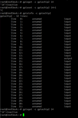

I am working on the i.MX93-EVK board. I flashed the imx-image-full-imx93evk.wic file from the LF_v6.6.52-2.2.0_images_IMX93EVK folder. When I try to set GPIO 14 to 1, it only changes the direction of the pin but does not set the pin to high.

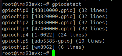

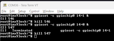

The gpiochip that manage the gpio14 (J1001 pin is the gpiochip0
