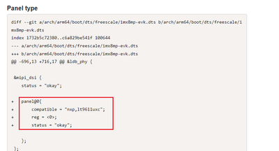

Zhiming_Liu
Hi @AlanWen
If you want to control it with LT9611 kernel driver, you need modify  LT9611 kernel driver.
If you just need firmware, you need use panel type in device tree.
Best Regards
Zhiming

Zhiming_Liu
Hi @AlanWen
If you want to use firmware to drive LT9611, you don't need linux driver, just set it as simple panel like knowledge base did.
If you want to drive it with Linux driver, you need refer Documentation/devicetree/bindings/display/bridge/lontium,lt9611.yaml to add i2c device node and add below node in root dts node.
model = "xxxxx"
hdmi-out {
		compatible = "hdmi-connector";
		type = "a";
		port {
			hdmi_con: endpoint {
				remote-endpoint = <&lt9611_out>;
If you face error about '-517',  you need adjust driver code, move lt9611uxc_attach_dsi function in
lt9611uxc_probe to lt9611uxc_bridge_attach.
Best Regards
Zhiming
