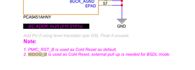

Zhiming_Liu
The WDG signal on EVK board will trigger cold reset.

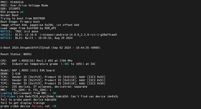

Zhiming_Liu
Did you modify that watchdog demo? I have tested that demo and the reset status is WDOG1.
