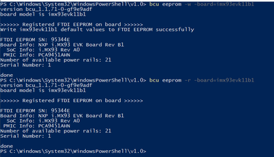

I had IMX93 A1 chip PIMX9352CVVXMAB, and trying to run bcu with our board and got error
"Can't auto recognize the board on location_id=1-1.4.2.1..."
I had tried to run with EVK which is A0  it seems working fine, but our boadrd wasn't. It looks like bcu was not support A1 chip right?eeprom.png

Manuel_Salas
Hello @Chihyu_Lin
I am not pretty sure if BCU is not prepared yet to display A1 SOC revision, but I wanted show to you that A1 and A0 works well in BCU from 1.1.71 version and higher.
Best regards!
Salas.

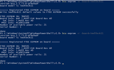

Manuel_Salas
Hello @Chihyu_Lin ,
The BCU is supported in both revision, A0 and A1.
I am trying to replicate your issue but unsuccessfully.
Here the logs from my A1 board:
And from A0:
Note at first I am doing a Write eeprom (-w) command and the BCU version I am using is 1.1.71.
Is there any thing that I can do for replicate this issue?
Best regards.
