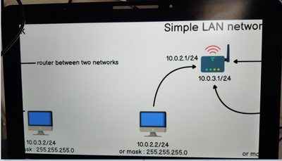

Hi, experts
We have encounter a display shifting issue when test our board, the screen resolution is 1920x1080, it sometimes has a large offset in the x direction.

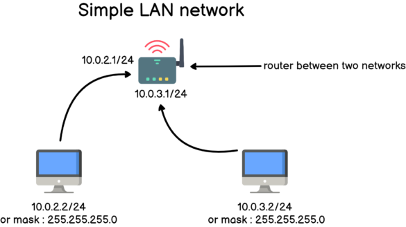

The origin image is as follows:
origin imageorigin image
It is worth noting that the screen does not shift every time when I boot the system. The probability of the screen shifting is about 1/15. The offset of the image on the screen in the x direction is the same every time.

I have dump the registers of the LCDIF and MIPI DSI when the screen is shift, the values are as following:

We are using `weston`  to test the display, only show a background.  I previously saved the drm buffer created by weston as a png image when the background image has a big offset, and found that the saved image was correct. so I think this is a driver related issue.
When the display shifting issue occurs, I restart the weston service, but the shift is always exist, but if I force off and on the card by the following command:
echo off > /sys/class/drm/card2-LVDS-1/status
echo on > /sys/class/drm/card2-LVDS-1/status
After these operations, the background on the screen displays normally.

I have used the image with the pixel of 1920x1080 to test the display, it still have the shifting issue,  please see the attachments. One is the origin image, the other one display with x offset.
I also check the log of weston, the display mode is correct, the size of the frame-buffer also correct(1920x1080x4 = 8294400)
