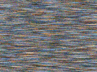

I applied the patches file into imx8m mini.And then I record a jpeg file from IMX258 but the file is not correct. I record the file as RAW10 RGGB format and convert it into jpeg file.
Test Command
gst-launch-1.0 v4l2src device=/dev/video0 num-buffers=1 ! video/x-bayer,format=rggb,width=1048,height=780 ! bayer2rgb ! videoconvert ! jpegenc ! filesink location=test.jpeg

try to use pngenc  or v4l2-ctl -d /dev/video0 --verbose --set-fmt-video xxx this command, I don't know what patch you apply, if still failed, pls dump the registers to double check, and check the logfile to trace, it's hard to find the root cause based on one picture
