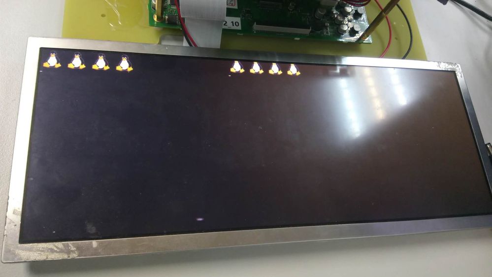

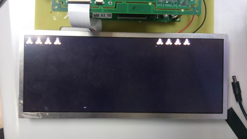

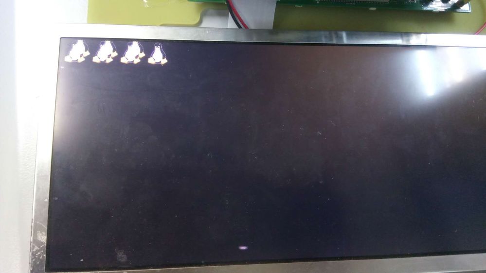

shalanyang
001.jpg002.jpg003.jpgI config the dts file as follow,can show the logo,but some time show two logs,the show picture see the attach

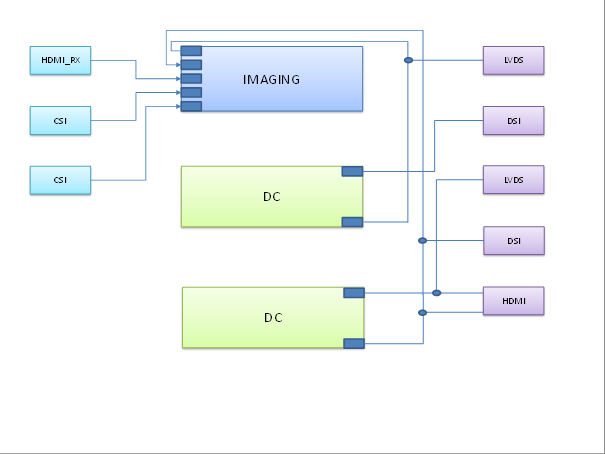

2,307 次查看
joanxie
The mapping is as follows -
DC0-0 -> MIPI-DSI0 / HDMI / ISI loopback
DC0-1 -> LVDS0 / HDMI
DC1-0 -> MIPI-DSI1
DC1-1 -> LVDS1 / ISI loopback
pls check if you connect correctly and  you use split mode for the dual lvds? did you enable dual channel for the picture?
