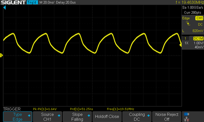

I'm having some issues adjusting drive strength for PTD22 pin on IMX8ULP based board.

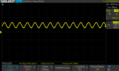

We're integrating a WiFi module that is interfaced through SDIO. The maximum supported SD clock for the WiFi module is 50MHz. But with that high of a clock, the driver fails to communicate with the module during large file transfers. The culprit looks like to be SD clock signal going to the module that doesn't look too good
Lowering the SD clock to 20 MHz helps with the timeouts and the driver works well, but that also limits the performance of the module and the clock still doesn't look too good on the scope.

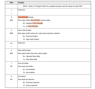

According to the IMX8ULP TRM, it should be possible to adjust drive strength for the SD clock pin. Setting it to high should help with the clock looking more like a square as it should, but it doesn't seem to do anything.

to set DSE bit 6 to 1, but the clock shape remains the same, it doesn't appear to change anything. I tried various other values for the PTD22 pin config but it always looks the same. Only the clock frequency can be changed.
I cross referenced the values with Config tool for i.MX.

I tried doing that but unfortunately, I do not see any change on the scope. It looks identical to the dts without DSE bit enabled.

Thank you for your interest in NXP Semiconductor products,
He means dynamically, you should update the u-boot DTS for the pin to use DSE=1 and SRE=0, so the pin configuration won't change.
It is recommended to use a high drive strength and a standard slew rate configuration for frequencies higher than 25MHz.
The total loading capacitance of the pin should be minimized (by PCB layout, connected IC input capacity, etc) to achieve better results.
