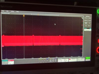

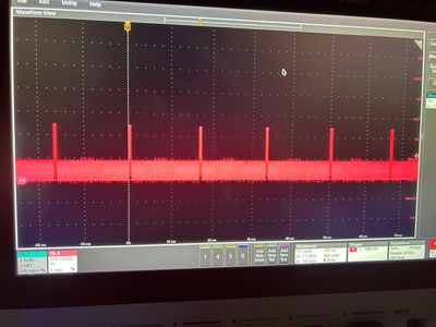

i compare imx8ulp with imx8mm in the same configure, i find the waveform is different
imx8mm waveform
imx8ulp waveform

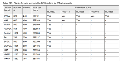

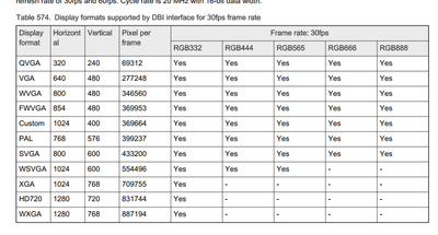

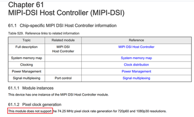

The DSI in i.MX8ULP can't support 1080p30.
The supported resolution are here:
Zhiming_Liu_1-1744081810993.pngZhiming_Liu_2-1744081819158.pngZhiming_Liu_3-1744081829926.png
