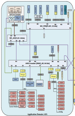

Hi, is possible to move a peripheral assigned to M33 core ?
For example gpio bank a/b/c are assigned to M33 core and if I want to use from A35 I need to use the fsl,imx-rpmsg-gpio driver but M33 is the controller.
Is possibile to assign these gpio directly to A35 core?

Hello @mirkoardinghi1
You can refer to IMX8ULP Reference Manual in section 2.1.3 Architecture diagram.
There you can see the Domains of cores:
As you can see, the the only peripherals accessible for cortex A are (check dts

And here the accesibles for M core (Included GPIO A, B, C and I2S0):
As the peripherals are from different domain (Real time domain for M core and Application domain for A core) all the peripherals are not accessible for A core.

Hi, yes I can assign with, for example  with bank c,
rpmsg_gpioc: gpio@2 {
compatible = "fsl,imx-rpmsg-gpio";
port_idx = <2>;
gpio-controller;
#gpio-cells = <2>;
#interrupt-cells = <2>;
interrupt-controller;
interrupt-parent = <&rpmsg_gpioc>;
status = "okay";
but this gpio use a special drive that demands the control to M33, I would like to use the banks a,b,c like the others
Same problem with I2S0 controlled by M33
