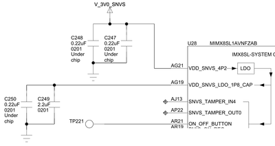

Problem/Observation:

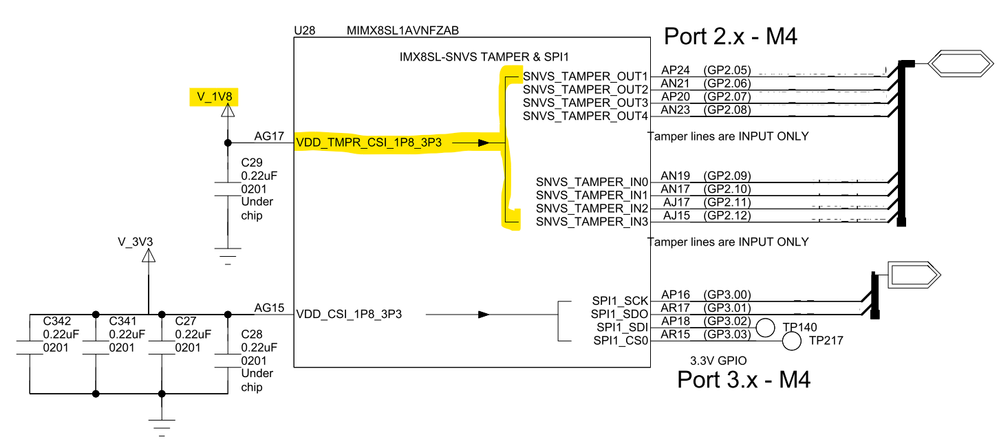

Using the IMX8SXL. We are using the "TAMPER" pins as GPIO. The idea is that they are used in a way that all 8 pins are pulled up internally. Then there are certain pins that have a 0 ohm pulldown so that the software can read these pins and understand what Hardware it is running on.
The very odd thing that was not expected, is that when the voltage is measured on these lines, we see 2.5V. Our expectation is that they would just be pulled up to the supply that is fed to AG17, which on our board is 1.8V. We have verified that our 1.8V supply is correct. We also do not have a 2.5V supply on the board.

Was the voltage measurement performed in both IN and OUT pins?
How is the connection in SNVS_LDO_1P8_CAP made?
How did you configure these pins as General Purpose?

reickhoff
 - Technically only the TAMPER_OUT pins because those pins are actually used by our software team meaning that they purposely set them as GPIO and enable the pullups. The TAMPER_IN pins are not actively used yet to my knowledge
I measure 1.785V on the LDO output
- Waiting for feedback from the software team. Is there something specific you are looking for?

JosephAtNXP
I see everything in the chip-side alright, I would like to see what the GPIOs are connected to, maybe the other circuitry has another pull up to 3.3V or the line has one.
And yes, I am looking in both hardware and software for meeting a document guidelines, could you verify it? It's an AppNote from a colleague attached.
I'll be waiting for the extra information to analyze it, but it is not desired, is another source or pull up that influences on GPIO.

reickhoff
they are either floating and nothing is attached (internal pullup makes it a 1) or they are shorted to ground with a 0ohm resistor (makes it a 0). So there is no other circuitry or any other voltage supplies.
