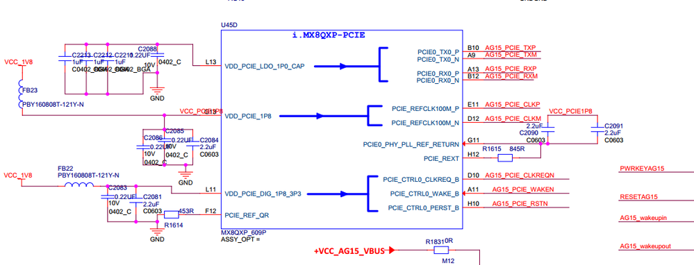

您好:
我用的是IMX8qxp,我们用的是pci的内部时钟,没有外接高精度的信号发生器。
l内核启动打印:(Linux version 4.14.78)
[ 0.948995] OF: PCI: host bridge /pcie@0x5f010000 ranges:
[ 0.949005] OF: PCI: No bus range found for /pcie@0x5f010000, using [bus 00-ff]
[ 0.949018] OF: PCI: IO 0x7ff80000..0x7ff8ffff -> 0x00000000
[ 0.949033] OF: PCI: MEM 0x70000000..0x7fefffff -> 0x70000000
[ 0.951582] imx6q-pcie 5f010000.pcie: ERROR PM_REQ_CORE_RST is still set.
[ 0.972396] imx6q-pcie 5f010000.pcie: pcie phy pll can't be locked.
[ 1.012421] imx6q-pcie 5f010000.pcie: failed to initialize host
[ 1.012426] imx6q-pcie 5f010000.pcie: unable to add pcie port.
我的原理图如下:

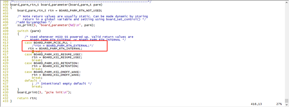

baiseyuzhou
最近很多人私聊我,问我这个问题怎么解决的,统一回复:
pcie使用内部时钟,需要打开内部时钟的初始化:
修改的文件如下:scfw_export_mx8/platform/board/mx8qx_mek/board.c
