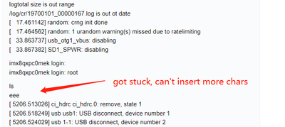

It's my yocto version configuration.
Yocto version: 5.4.24-2.1.0、5.4.70_2.3.6
DISTRO and MACHINE: DISTRO=fsl-imx-xwayland MACHINE=imx8qxpc0mek source imx-setup-release.sh -b imx8qxpc0mek_xwayland
targets: bitbake imx-image-core
using busybox as init manager,modified fsl-imx-preferred-env.inc
VIRTUAL-RUNTIME_init_manager = "busybox"
POKY_DEFAULT_DISTRO_FEATURES += " sysvinit"
I made 2 more partitions on my emmc, rootfs is at mmcblk0p2, and mmcblk0p3、mmcblk0p4 partition will auto mount.
We try to poweroff and boot the IMX8 board over and over again, but when poweroff 700-1000+ times, the system will get stuck without any wrong log print out. We just can't input any character by console. Of course, our application is background running. At first, I just think the reason of system stuck is something wrong is our application, but we notice the system will also get stuck before the app run. Then we stop the app auto start totally, system will still get stuck with very small probability. It will take a long time to recurrence the problem, so we just add some "sync" operation in the init scripts, probability become bigger. System get stuck when poweroff and boot about 1000 times.
We have tried using "mount" command to mount other partitions, but no effect. System works fine when just mount rootfs partition. We also tried using buildroot filesystem using the same partitions, buildroot works just fine after 30000 times booting ...
sometimes system got stuck before login.
We could not found any similar problem in community, could anyone give me some suggests.
System stuck log is above.

init started: BusyBox v1.31.0 (2021-06-09 06:12:44 UTC)
starting pid 228, tty '': '/bin/mount -t proc proc /proc'
starting pid 229, tty '': '/bin/mount -t sysfs sysfs /sys'
starting pid 230, tty '': '/bin/mount -t devtmpfs devtmpfs /dev'
mount: /dev: devtmpfs already mounted on /dev.
starting p[    2.789501] EXT4-fs (mmcblk0p2): re-mounted. Opts: (null)
id 231, tty '': '/bin/mount -o remount,rw /'
starting pid 232, tty '': '/bin/mkdir -p /dev/pts'
starting pid 233, tty '': '/bin/mount -t devpts devpts /dev/pts'
starting pid 234, tty '': '/bin/mount -a'
starting pid 235, tty '': '/etc/init.d/rcS'
Starting udev
[    2.939642] udevd[254]: starting version 3.2.8
[    2.946464] random: udevd: uninitialized urandom read (16 bytes read)
[    2.953360] random: udevd: uninitialized urandom read (16 bytes read)
[    2.959873] random: udevd: uninitialized urandom read (16 bytes read)
[    2.983486] udevd[255]: starting eudev-3.2.8
[    3.125141] [VPU Encoder] enable mu for core[0]
[    3.138065] [VPU Encoder] vpu encoder core[0] firmware version is 1.2.7
[    3.787314] EXT4-fs (mmcblk0p3): mounting ext3 file system using the ext4 subsystem
[    3.840313] EXT4-fs (mmcblk0p4): recovery complete
[    3.845721] EXT4-fs (mmcblk0p3): recovery complete
[    3.846056] EXT4-fs (mmcblk0p4): mounted filesystem with ordered data mode. Opts: (null)
[    3.858698] EXT4-fs (mmcblk0p3): mounted filesystem with ordered data mode. Opts: (null)
[    3.868678] FAT-fs (mmcblk0p1): Volume was not properly unmounted. Some data may be corrupt. Please run fsck.
/etc/rcS.d/S38dmesg.sh: line 17: /var/log: Is a directory
Starting vsftpd: OK
Starting system message bus: [    4.061511] urandom_read: 3 callbacks suppressed
dbus.
[    4.061519] random: dbus-daemon: uninitialized urandom read (12 bytes read)
[    4.070570] random: dbus-daemon: uninitialized urandom read (12 bytes read)
Starting Connection Manager
Configuring network interfaces... [    4.173284] random: connmand: uninitialized urandom read (8 bytes read)
[    4.225538] ybx ,ret=0
[    4.228821] RTL9000AA/AN Ethernet 5b040000.ethernet-1:00: attached PHY driver [RTL9000AA/AN Ethernet] (mii_bus:phy_addr=5b040000.ethernet-1:00, irq=POLL)

[   17.461142] random: crng init done
[   17.464562] random: 1 urandom warning(s) missed due to ratelimiting
[   33.863737] usb_otg1_vbus: disabling
[   33.867382] SD1_SPWR: disabling
imx8qxpc0mek login:
imx8qxpc0mek login: root
ls
eee
[ 5206.513026] ci_hdrc ci_hdrc.0: remove, state 1
[ 5206.518249] usb usb1: USB disconnect, device number 1
[ 5206.524029] usb 1-1: USB disconnect, device number 2
[ 5206.582439] ci_hdrc ci_hdrc.0: USB bus 1 deregistered
[ 5211.599714] ci_hdrc ci_hdrc.0: timeout waiting for 00000800 in OTGSC
