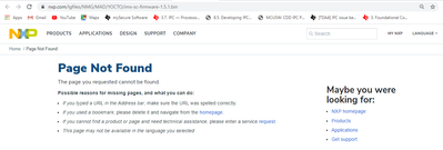

I am building YOCTO Rev. L5.4.24_2.1.0 image(imx-image-core) for IMX8QXP,
ERROR: imx-sc-firmware-1.5.1-r0 do_fetch: Fetcher failure: Fetch command export PSEUDO_DISABLED=1; unset _PYTHON_SYSCONFIGDATA_NAME; export DBUS_SESSION_BUS_ADDRESS="unix:path=/run/user/1000/bus"; export PATH="/home/kpit/imx/sources/poky/scripts:/home/kpit/imx/build-xwayland/tmp/work/imx8qxpmek-poky-linux/imx-sc-firmware/1.5.1-r0/recipe-sysroot-native/usr/bin/aarch64-poky-linux:/home/kpit/imx/build-xwayland/tmp/work/imx8qxpmek-poky-linux/imx-sc-firmware/1.5.1-r0/recipe-sysroot/usr/bin/crossscripts:/home/kpit/imx/build-xwayland/tmp/work/imx8qxpmek-poky-linux/imx-sc-firmware/1.5.1-r0/recipe-sysroot-native/usr/sbin:/home/kpit/imx/build-xwayland/tmp/work/imx8qxpmek-poky-linux/imx-sc-firmware/1.5.1-r0/recipe-sysroot-native/usr/bin:/home/kpit/imx/build-xwayland/tmp/work/imx8qxpmek-poky-linux/imx-sc-firmware/1.5.1-r0/recipe-sysroot-native/sbin:/home/kpit/imx/build-xwayland/tmp/work/imx8qxpmek-poky-linux/imx-sc-firmware/1.5.1-r0/recipe-sysroot-native/bin:/home/kpit/imx/sources/poky/bitbake/bin:/home/kpit/imx/build-xwayland/tmp/hosttools"; export HOME="/home/kpit"; /usr/bin/env wget -t 2 -T 30 --passive-ftp --no-check-certificate -P /home/kpit/imx/downloads/ 'https://www.nxp.com/lgfiles/NMG/MAD/YOCTO/imx-sc-firmware-1.5.1.bin' --progress=dot -v failed with exit code 8, output:
--2021-03-09 21:48:09-- https://www.nxp.com/lgfiles/NMG/MAD/YOCTO/imx-sc-firmware-1.5.1.bin
Resolving www.nxp.com (www.nxp.com)... 104.122.7.61
Connecting to www.nxp.com (www.nxp.com)|104.122.7.61|:443... connected.
HTTP request sent, awaiting response... 404 Not Found
2021-03-09 21:48:11 ERROR 404: Not Found.

Hi Arjun,
you may try to change version of imx-sc-firmware-1.5.0.bin to imx-sc-firmware-1.6.0.bin in /source/meta-freescale/recipe-bsp/imx-sc-firmaware/imx-sc-firmware(your version).bin.
For example it can be done with this commit
https://github.com/Freescale/meta-freescale/commit/c16bc6e4bb4580769ea8fe3440c8fda3bb532a30
Also update licence policy here:  classes/fsl-eula-unpack.bbclass
Last thing is:
cp imx-sc-firmware_1.6.0.bb to sources/meta-imx/meta-bsp/recipes-bsp/imx-sc-firmware/  and delete old version of imx-sc-firmware_x.x.x.bb
After these changes, I successfully build the image.
Martin D.
