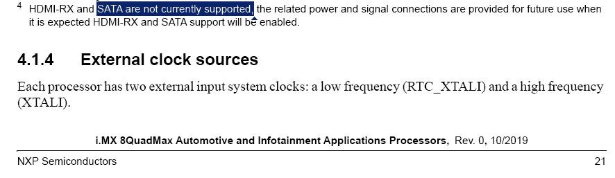

our designed board use msata only  ,so there is not external clk source ,so we set ext_osc =0 . boot log occur
[ 1.440584] iommu: Adding device 5f020000.sata to group 0
[ 1.449801] ahci-imx 5f020000.sata: internal pll is used.
[ 1.455363] ahci-imx 5f020000.sata: TX PLL of the PHY is not locked
[ 1.461644] ahci-imx 5f020000.sata: failed to reset phy: -19
how can i resolve this issue? thank you!
546 Views
igorpadykov
Hi bin
sata currently is not supported as described on p.21
i.MX 8QuadMax Automotive and Infotainment Applications Processors
igor
