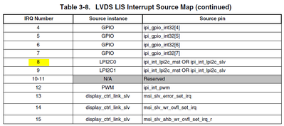

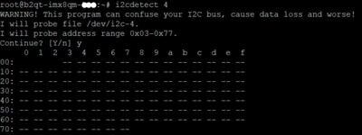

2,987 Views
sig0912
So I changed the interrupt value to 8 for the i2c0_lvds0 node
Looks like the lvds0 i2c0 is mapped to i2c-4
Still can't detect anything on the LVDS0 I2C0
Any ideas?
