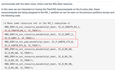

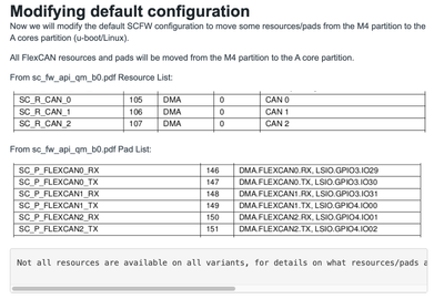

 Hı, Thank you for reply.
How can I compile scfw on yocto and change uart1 to uart4 for imx8qm. And then how can I flash the imx8qm.
2,477 Views
Zhiming_Liu
Hi @HAKANAYDN
Refer this to compile scfw firmware on Ubuntu, not yocto.
https://community.nxp.com/t5/i-MX-Processors-Knowledge-Base/System-Controller-Firmware-101-Getting-s...
Then find and replace scfw_tcm.bin in Yocto.
2,425 Views
HAKANAYDN
Where do I fix inside source code of scfw in order to change from uart1 to uart4 for console ? After I apply it, do I need to do something inside kernel, uboot and dts files ? After I compiled scfw file, how can I combine u-boot.bin both of them ? How can I flash ?
2,382 Views
Zhiming_Liu
You should refer the knowledge base :https://community.nxp.com/t5/i-MX-Processors-Knowledge-Base/System-Controller-Firmware-101-Resource-...
after I apply it, do I need to do something inside kernel, uboot and dts files ?
-->Yes, you need configure uboot and kernel serial index in dts.
-->Please refer 4.5.13 How to build imx-boot image by using imx-mkimage in this guide.
https://www.nxp.com/docs/en/user-guide/IMX_LINUX_USERS_GUIDE.pdf
