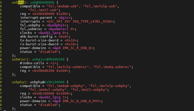

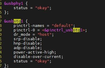

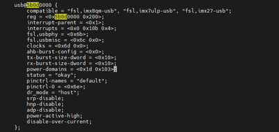

dts config in imx8-ss-conn.dtsi
dts config in imx8qm-mek.dts

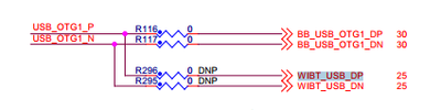

I'm using the M.2 connector on CPU board, instead of the connector on the base board. Also, I found below description:
should I connect R295//R296 and remove R117 & R116, if I want to use the M.2 connector on the CPU board?
