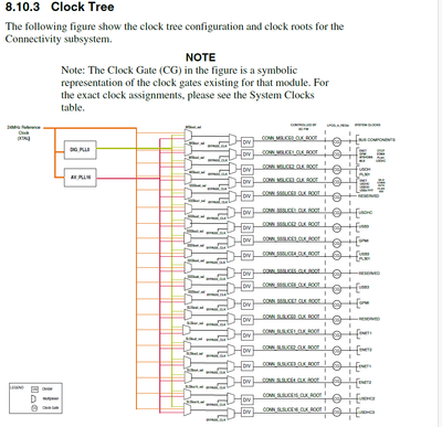

We are debugging an issue with the RGMII TXC clock generated by the ENET MAC where the TXC is off by a very tiny amount on a board with IMX8QM processor. We are feeding output of a 24MHz clock crystal to the SoC  whose error is within 30ppm.  The ENET1 MAC is connected to a PHY through RGMII. As per the requirement by the PHY Chip manufacturer, this clock should be between 124.99375 and 125.00625 (+/- 50ppm). What we observed was 124.98620 MHz ( equivalent of -110 ppm). This, according to the PHY manufacturer can cause errors, especially during high temperature operations (which we are observing).
Can you guide me how the 24Mhz input clock to the SoC (XTAL) gets translated to the RGMII TXC (125Mhz for RGMII operation) coming out of the MAC ?
I saw this in the IMX8QMRM
I am trying to understand what path the clock takes to get the ENET1_TXC (125Mhz). Specifically,
  1. Which PLL ( 24Mhz or AV_PLL16 or DIG_PLL0) does get used to generate TXC ?
  2. Which one is the root clock for TXC ? For example CONN_SLSLICE1 or CONN_SLSLICE3_CLK_ROOT for ENET1.
  3. How do I read the values of DIV and SLSlice<>_sel mentioned above?.  I believe all these are done in the SCFW ? If so, can you help me pin point where it is done?

The DIV/MULT values is setting in below .o file, the functions should be called by scfw api.
dts==>linux clock driver==>scfw api==>scfw dsc driver.
imx-scfw-porting-kit-1.18.0/src/scfw_export_mx8qm_b0$ grep -r "DSC_MSliceGetDiv"
platform/drivers/dsc/fsl_dsc.h:void DSC_MSliceGetDiv(sc_dsc_t dsc, dsc_mslice_div_t *p_mslice_div);
grep: build_mx8qm_b0/drivers/dsc/fsl_dsc.o: binary file matches
If you want to change the clock rate, i think the fastest way is to modify ethernet dts property.
assigned-clock-rates = <250000000>, <125000000>;

Zhiming_Liu
Hi @mahesh_hns
1. The 125MHz is from AV_PLL16. For 24Mhz bypass, it's not used after Ethernet PLL is stable. It's just a transition clock.
2. I don't think modifying the crossover value will solve the problem.
3. Since the hardware design manual's clock jitter requirement for the enet is 50ppm, I don't think there's any need to worry about internal PLL jitter causing this value to be larger.
4. For the 24MHz input design, the following points need to be noted in Hardwarre Developer's Guide. The default setting for internal capactior is BRD_OSC_CAP_TRM_VALUE_24M[3..0]=1010-->20pf. The default values were selected specifically for the MEK reference designs and should prove good enough for other designs in general.
It may have something to do with the setting of this value, after making sure that there is nothing need to adjust with the design of your 24Mhz peripheral circuits. Careful burning thes bits of fuse is required.
Have you measured the 24MHz crystal jitter above the chip's input pins? If it is confirmed that the 24Mhz jitter received by the chip meets the requirements, then the only thing left to adjust are these bits in the fuse.
Zhiming
