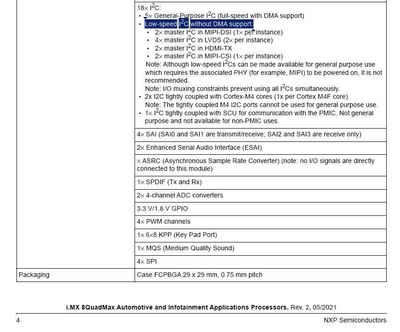

Hi Mohamed
not all i2c have dma supported as described in datasheet
i.MX 8QuadMax Automotive and Infotainment Applications Processors
igor
