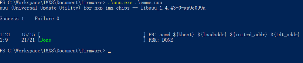

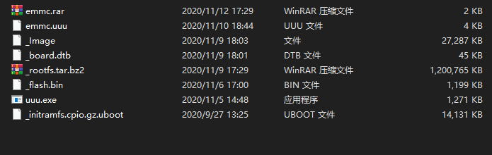

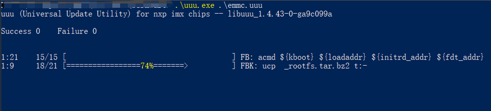

6、use uuu burn image on win10
copy and rename linux-imx/arch/arm64/boot/Image to _Image
copy and rename linux-imx/arch/arm64/boot/dts/freescale/imx8mq-evk.dtb to _board.dtb
copy and rename imx-yocto-bsp/build-wayland/tmp/deploy/images/imx8mqevk/imx-image-full-imx8mqevk-20201021065034.rootfs.tar.bz2 to _rootfs.tar.bz2
copy and rename imx-mkimage/iMX8M/flash.bin to _flash.bin
copy and rename L5.4.47-2.2.0_images_MX8MQEVK/fsl-image-mfgtool-initramfs-imx_mfgtools.cpio.gz.u-boot to _initramfs.cpio.gz.uboot
uuu.exe emmc.uuu
Snipaste_2020-11-12_17-31-53.pngSnipaste_2020-11-12_17-31-53.pngSnipaste_2020-11-12_17-54-39.pngSnipaste_2020-11-12_17-54-39.pngSnipaste_2020-11-12_18-01-45.pngSnipaste_2020-11-12_18-01-45.png

FBK: ucmd mmc=`cat /tmp/mmcdev`; mount /dev/mmcblk${mmc}p2 /mnt/ext3
FBK: acmd export EXTRACT_UNSAFE_SYMLINKS=1; tar -jx -C /mnt/ext3
FBK: ucp _rootfs.tar.bz2 t:-
FBK: Sync
FBK: ucmd umount /mnt/ext3
FBK: DONE
Thank you.
9,084 Views
Rita_Wang
I have saw your details, your steps are OK no errors found. The fail boot caused by the unreasonable set in kernel command line. As you renamed the download images name, so when uboot boot up you need also to unify the name in kernel boot up. When your uboot boot up, print and modify. It will also work OK. You can try.
