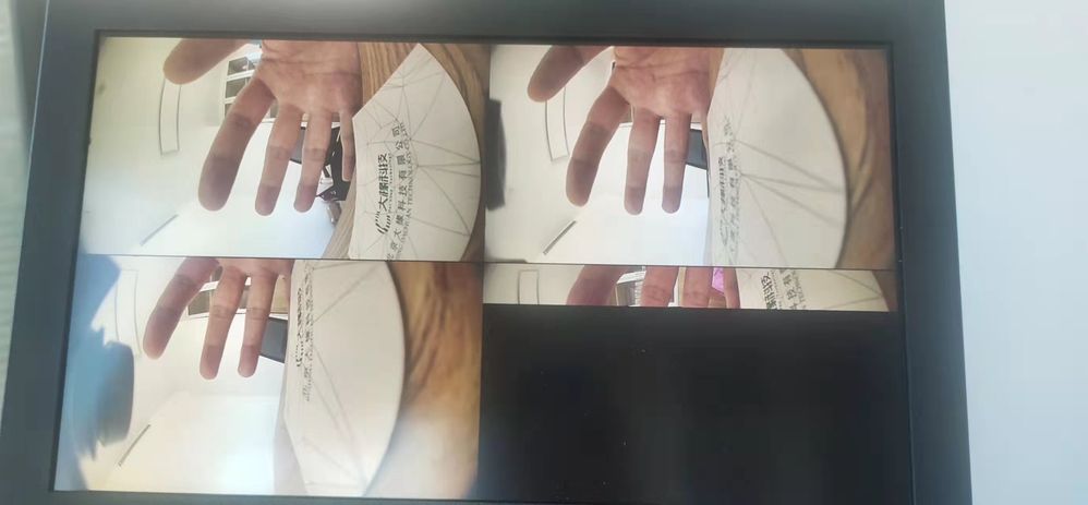

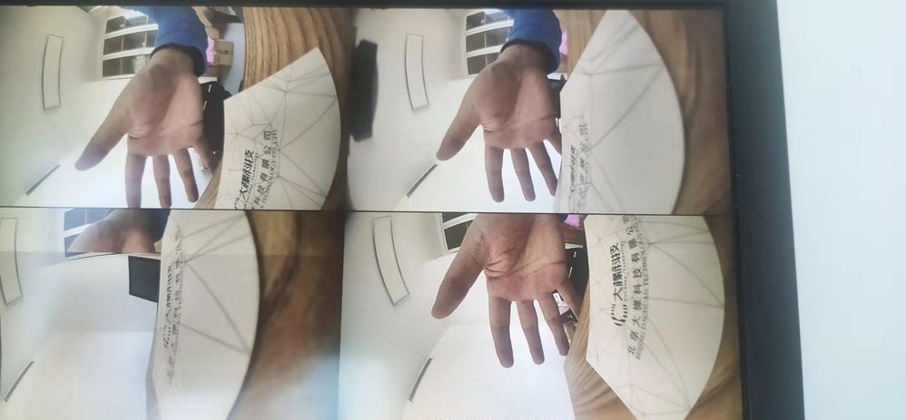

My IMX8QM board connects 4 1280*720 cameras by TI UB960 with 30Hz frame rate .
Now the four images can display on the screen, but there is always one camera data which is not completely, and the incorrect one is random in the 4 cameras.
The attached image shows this situation. The bottom left image only real-time display 1/4 of the full picture, the remain part can't update.
Maybe the CSI-2 bandwidth isn't enough for the 4 lanes data, but how to adjust the CSI-2 bandwidth to solve this problem?
Please give me some advise. Thanks in advance!

Hi Taotao
what bsp used in the case, may be recommended to try latest as they have many improvements
https://www.nxp.com/design/software/embedded-software/i-mx-software/embedded-linux-for-i-mx-applicat...
Also recommended to use latest RPA tool for ddr configuration
https://community.nxp.com/t5/i-MX-Processors-Knowledge-Base/i-MX8QM-DDR-Register-Programming-Aid-RPA...
For cameras may be useful below patches
https://community.nxp.com/t5/i-MX-Processors-Knowledge-Base/Nvp6324-driver-for-imx8qm/ta-p/1114616

Hi Igor
Thanks for your quickly respose.
Our BSP version is 4.14.78. Based on this version , I have made the max9286 and nvp6324 worked correclty. But for the UB960, there is this problem like the upper mentioned.
Later I will try with the latest version.
