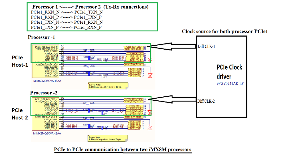

In one of the hardware designs we are planning to establish a communication link between two IMX8MQ processors. For that we are planning to use the PCIe as the communication medium. The reason we are trying to establish a connection using PCIe is to save the PHY space in the circuit.
On the hardware front, we are planning to establish communication using as per the below diagram.
  1. Can you please help to verify the hardware connections and check whether this design is feasible or not from the standard point of view?

Hi  Harshit
yes this design is feasible, also one can look at below link
(as pcie module is similar to i.MX6)

Thank you for your reply and confirmation of the hardware connections.
We are planning to use the Linux reference here. From the Linux release notes manual I verified that the EP and RC mode support is there in i.MX8MQ processor.
  1. From the link, you have shared in the above reply specifies that the external clock is not required, we can go with the internal PCIe clock in EP. Please confirm.

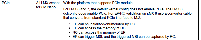

  2. In the previous link we got the following information. However, we are not able to access those files. Can you please provide us the same?pastedImage_2.png

1, yes in this case internal PCIe clock can be used.
