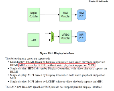

1. Now it's DCSS connected to HDMI, and then LCDIF connected to MIPI;
According to this diagram, can DCSS connect to HDMI and MIPI?
2. Dual screen display, can both MIPI and HDMI display Weston, as well as Little Penguin and E interfaces? How do we configure it?
Can the MIPI screen display the QT interface?

A1.Yes,
A2. No since the driver for MIPI start after it boot the kernel you must see the penguin just in one display, at least you have initialize the MIPI on uboot. and you will have both screen. You can program you app to run in both display.
