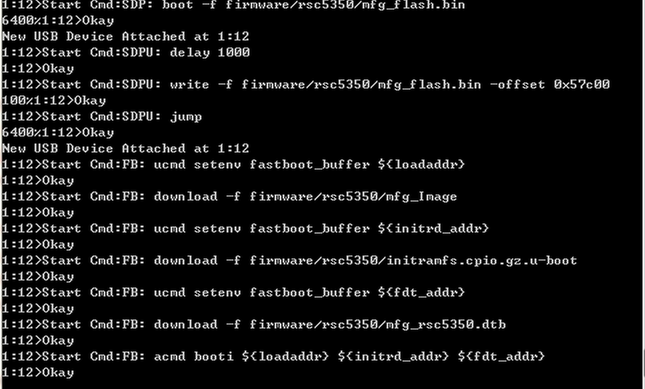

    when I plug the USB A-to-A cable into the board port1 and PC , then launch uuu program, the flash.bin dtb and ramdisk can be download into the board ram by the uuu, but the program will be stop when kernel and ramdisk boot up, the console print:
  No udc available !
 All the result images is following
   Above image is from PC uuu command
   This result is from linux console.
   That mean USB can't be connect with PC and board

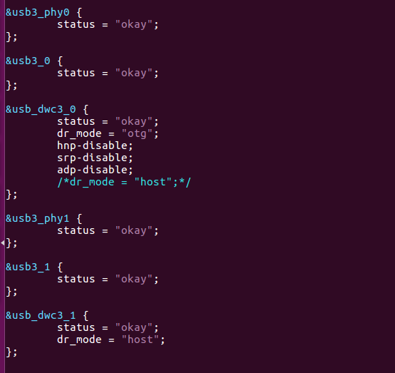

   I configure the USB3 port1 as OTG and USB3 port2 as Host, the device tree is listed

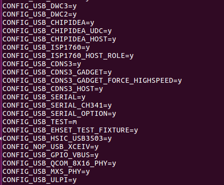

my kernel config is listed
      I changed the USB3 port1 as the USB higg-speed intead of superspeed
    because I'm afraid my usb cable speed, but the program always exist!
    So what can I do? Where could I chang ?
