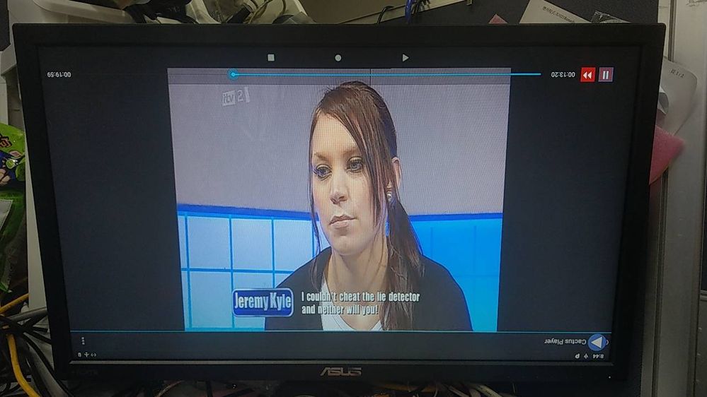

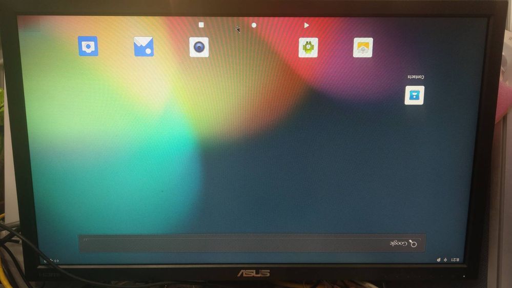

IMX8MQ  Android 9.0.1 and  9.0.2 screen turned to 180,
the video playback did not turn to 180.
Use this command:
"settings put system user_rotation 2"
Can someone help improve this problem?

diegoadrian
Hello
To rotation the screen, you can add followed two lines in init.rc, both video and GUI are rotated.
  setprop persist.demo.rotationlock true
  setprop persist.demo.remoterotation portrait
Hope this information could help you.
Diego.
