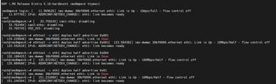

I meanwhile learned, that half-duplex operation only works with a single transmit queue [1]. Could it be that such configuration differs between L5.10.72 and LF5.15.5_1.0.0?

Zhiming_Liu
This issue can't reproduce in L5.10.72.I will report this issue.
