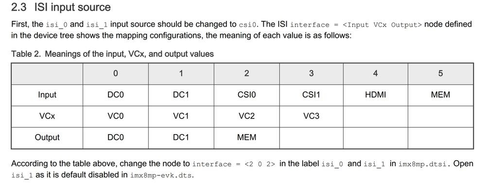

I did some experiments few days ago, so here is what I have noticed:
I edited a bit imx8mp.dtsi file to configure isi_1 as m2m device too. I modified imx8mp-evk-basler-ov5640.dtb to enable isi_1, isi_0 and isp_0. After booting the board I am able to find the Gstreamer plugin for m2m:
root@imx8mpevk:~# gst-inspect-1.0 | grep v4l2
video4linux2: v4l2src: Video (video4linux2) Source
video4linux2: v4l2sink: Video (video4linux2) Sink
video4linux2: v4l2radio: Radio (video4linux2) Tuner
video4linux2: v4l2deviceprovider (GstDeviceProviderFactory)
video4linux2: v4l2convert: V4L2 Video Converter
video4linux2: v4l2video3convert: V4L2 Video Converter
video4linux2: v4l2h264enc: V4L2 H.264 Encoder
video4linux2: v4l2h265enc: V4L2 H.265 Encoder
video4linux2: v4l2h264dec: V4L2 H264 Decoder
video4linux2: v4l2h265dec: V4L2 H265 Decoder
video4linux2: v4l2vp8dec: V4L2 VP8 Decoder
video4linux2: v4l2vp9dec: V4L2 VP9 Decoder
as well as the m2m_devices:
root@imx8mpevk:~# v4l2-ctl --list-devices
mxc-isi-m2m (platform:32e00000.isi:m2m_devic):
/dev/video2
mxc-isi-m2m (platform:32e02000.isi:m2m_devic):
/dev/video3
VIV (platform:viv0):
/dev/video5
So I created a quick pipeline and redirected isp_0 to both isi_0 and isi_1.
gst-launch-1.0 v4l2src device=/dev/video5 num-buffers=20 ! video/x-raw, width=1920, height=1080, framerate=60/1 ! tee name=t ! queue ! v4l2convert ! video/x-raw, width=1920, height=1080, format=RGB16 ! vpuenc_h264 ! queue ! filesink location=out1.h264 t. ! queue ! v4l2video3convert ! video/x-raw, width=1280, height=720, format=BGRA ! vpuenc_h264 ! queue ! filesink location=out2.h264
In my case v4l2convert will use /dev/video2 which is mapped to isi_0 and v4l2video3convert will use /dev/video3 which corresponds to isi_1. Used the tee element which splits the data in 2 identical ways, so at the end I have 1920x1080 and 1280x720 video streams.
Let me know if this is helpful.
Diana

I learned something in your and Khang's feedback: One can configure ISI to do m2m access as can be seen in https://www.nxp.com/docs/en/application-note/AN13430.pdf page 3
isi interface = <5 0 2>.
