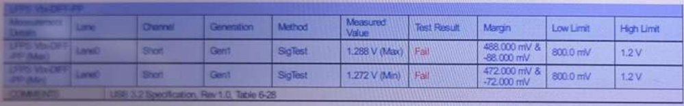

My customer board run eye pattern in USB3.0 is fail.
LFPS VTX-DIFF-PP (0.8~1.2V)
MAX: 1.288V Fail
MIN: 1.272V Fail
Please suggest what is the next step to debug on this issue.  Thanks!

HI FoxYang:
Did you fix the issue ? I  also got the same issue .
Could you provide my the solution ?

Hello @FoxYang ,
I found a similar issue:
https://e2e.ti.com/support/interface-group/interface/f/interface-forum/955630/tusb544-lfps-vtx-diff-...
Could you please check it?
